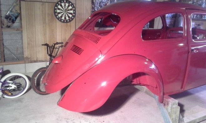

the good.
the bad.
the gun spat here on the left rear fender.
so I stuck heaps of paint over it so I can hopefully polish it out, so it sagged here.
and when painting inside the air vent I made this mess, looks like I'll be learning to wet sand paint now!
All in all I'm pretty stoked and glad it's over, heaps of runs and spots of over spray and areas of orange peel etc..
but not bad for a noob in a shed in west auckland.
looking forward to assembly.

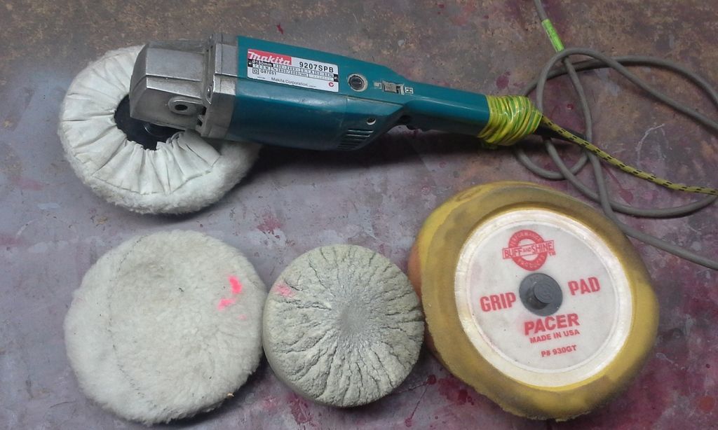

just went down to the paint shop at got some 1000-1500 paper and polishing gunk, the old fulla there says I'll have to leave the enamel paint for about 3 months before I can sand and buff it out as it needs to be dry and hard all the way though to shine after buffing?
Was hoping to sand and buff it before assembly, looks like I'm building a car this weekend!
