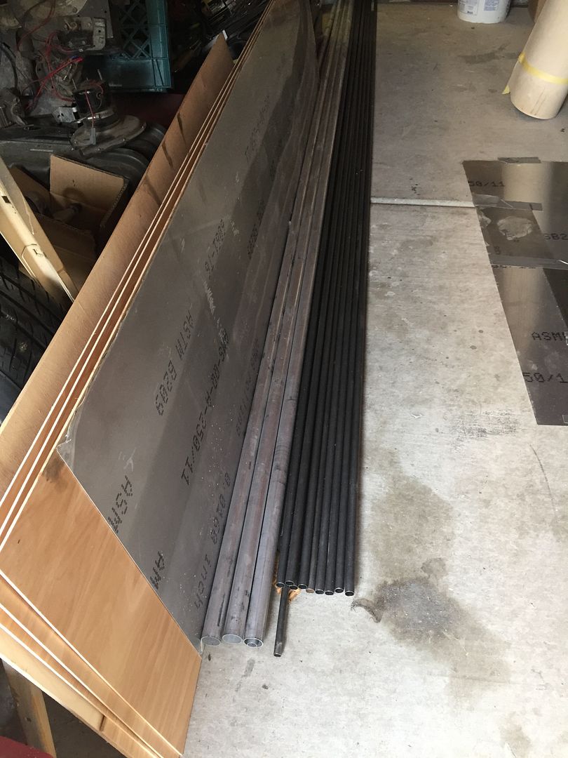

My kit. Looks like a bunch of random stuff, but it is all the wood for the wing and steel tube for the fuselage.

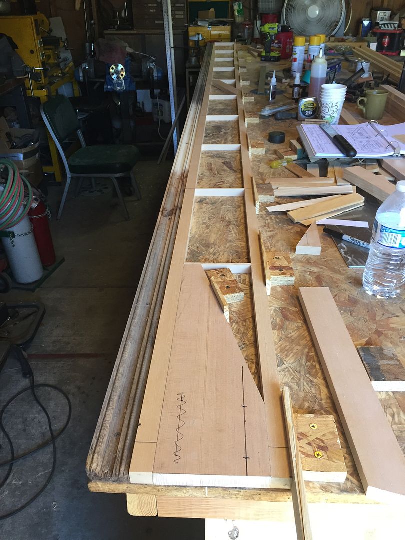

First leading edge spar laid up and glued. This picture just shows the layup. I have wax paper under all the glue joints now, just no picture of that step. Build one more in reverse, and then on to the rears. Goes pretty fast if you work steady and stop daydreaming. Wink

NIce looking pile of Sitka. Spar jig looking awesome. The woodworking part I get, but the TIG welding for the fuselage...
Posts: 2005
Re: New project in the werks for Big Ben
Postby BBWB » Tue Jul 18, 2017 7:02 am
^^^I'll actually be using acetylene gas for the welding. The reason being that it pre-heats the weld area before any actual weld takes place, thus making the weld less brittle. I could TIG, but don't have one handy, and I'd have to pre-heat every weld joint before TIG'ing.

No mig welding then.
Heating all the joints to relieves stress?
Posts: 2005
Postby BBWB » Tue Jul 18, 2017 8:18 am
^^^ Yep. That's what I've read on all the build sites and you-tube vids.
